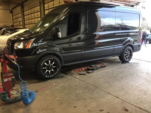

I replaced my stock tires last month. Went with BFG KO2 245/75/16
Also swapped out the stock silver rims with stock black rims. Didn't want to spend more than I had to, and I like the look of the black stock rims just fine. The only thing I did was hammer the pinch weld down on the back side of the front wheel wells. It has enough clearance at every position the wheel is turned. I think the closest it ever gets is maybe 1/4" while the wheel is rotated out, but there hasn't been any rubbing at all. Put about 2000 miles on so far. They are about 2 1/2" bigger in diameter than those tiny stock tires. To me it makes a huge difference in the look, and gives me slightly more clearance too. I'm happy with them. Before and after photos.
135472
135473

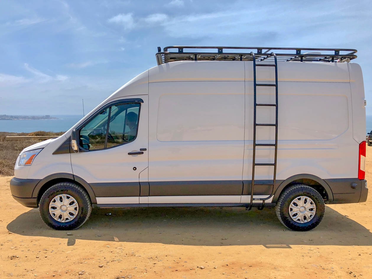

-Cooper Discovery AT3 LT 245/70R17 30.5" on Method 701's - 17" x 7.5"
-Pinch weld modded, no other clearance issues.
135859
