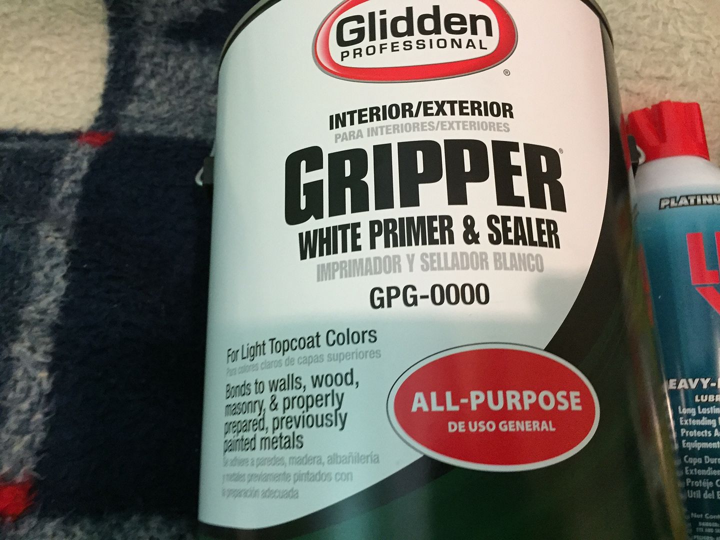

I cut thinsulate to size then paint Gripper on van wall
push thinsulate in place let dry
OR
put thinsulate in place -
then using Squirt bottle
squirt slightly thinned Gripper High up on van
wall and let run down wall - push thinsulate in place
Both techniques worked well -
I used 3M #90 to glue thinsulate in place over cab headliner -
worked well there -
used Gripper everywhere else to install thinsulate-
Gripper works Real good on layers of ridged foam -
also used Great Stuff to glue Ridged foam in place on ceiling -
all worked well -
