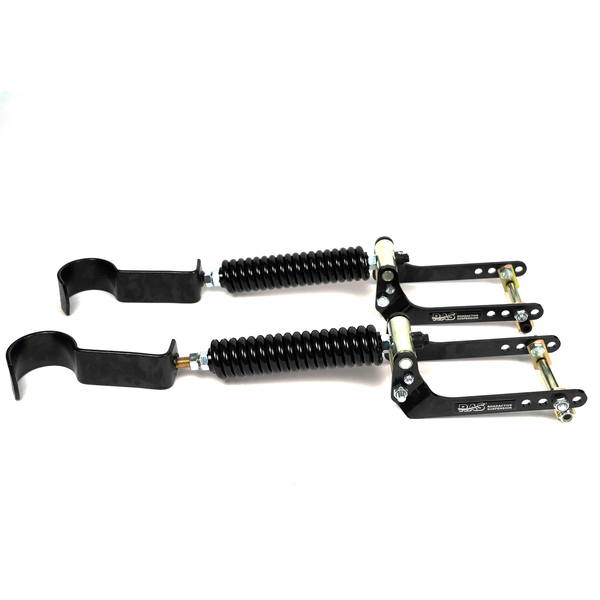

157310
#18 ·
157352
Not cheap but I would love to have one of these!
But yeah, if you're hauling a lot you should start with airbags for sure.
