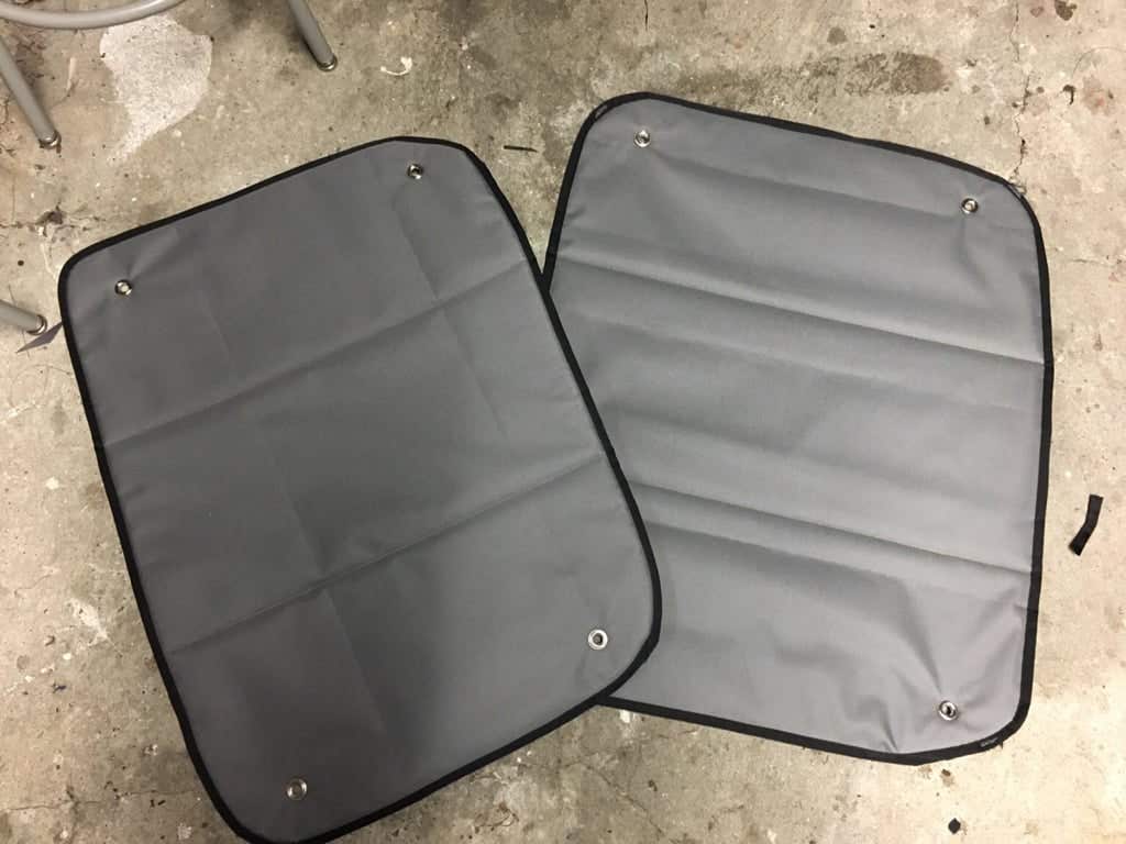

I made another set of rear door covers today out of the diamond ripstop and must admit that they're much easier to sew. The only problem is that this fabric is three times the cost of the pvc polyester. I think I will use this stuff going forward, but prices will increase. Check out the new version and the storage bag that was a request from a forum member.

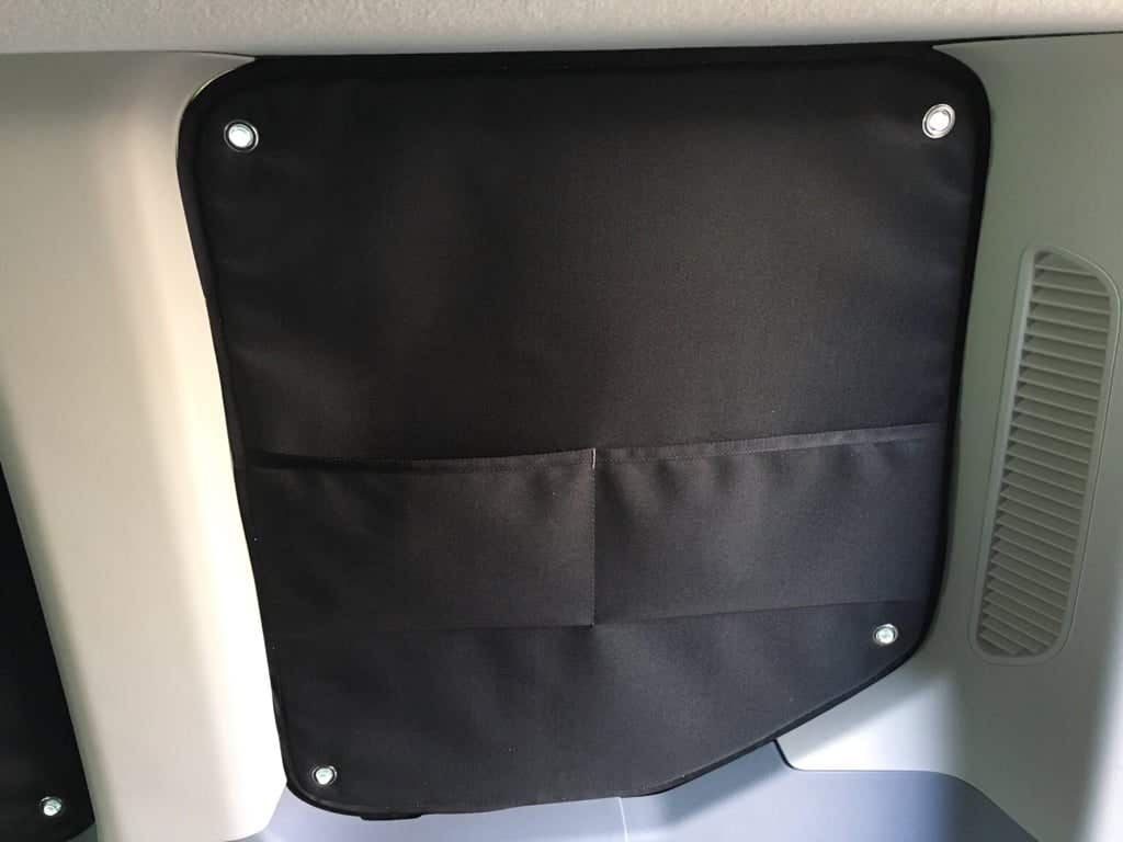

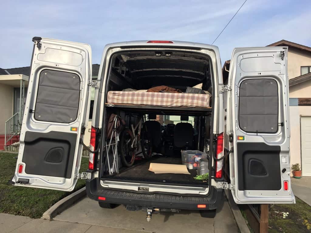

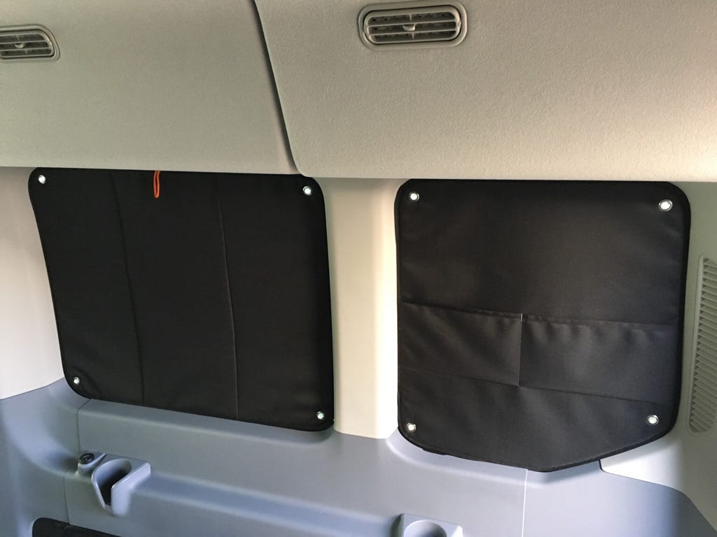

The high roof cargo is my friend's van. Really like the high roof. Our medium roof wagon got some updated side window covers and rear door covers today with pockets. I plan on using the pockets on the doors for surf wax, bike tools, and a couple headlamps.
