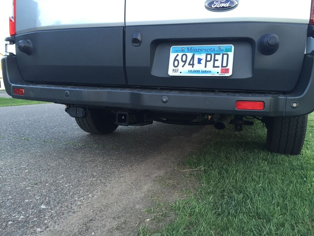

I've got a curt class 4 sitting in the box in my foyer right now, waiting for me to have a minute to install it. No trailer wiring yet, but honestly my primary use case will probably be a 2 bike carrier for a while.

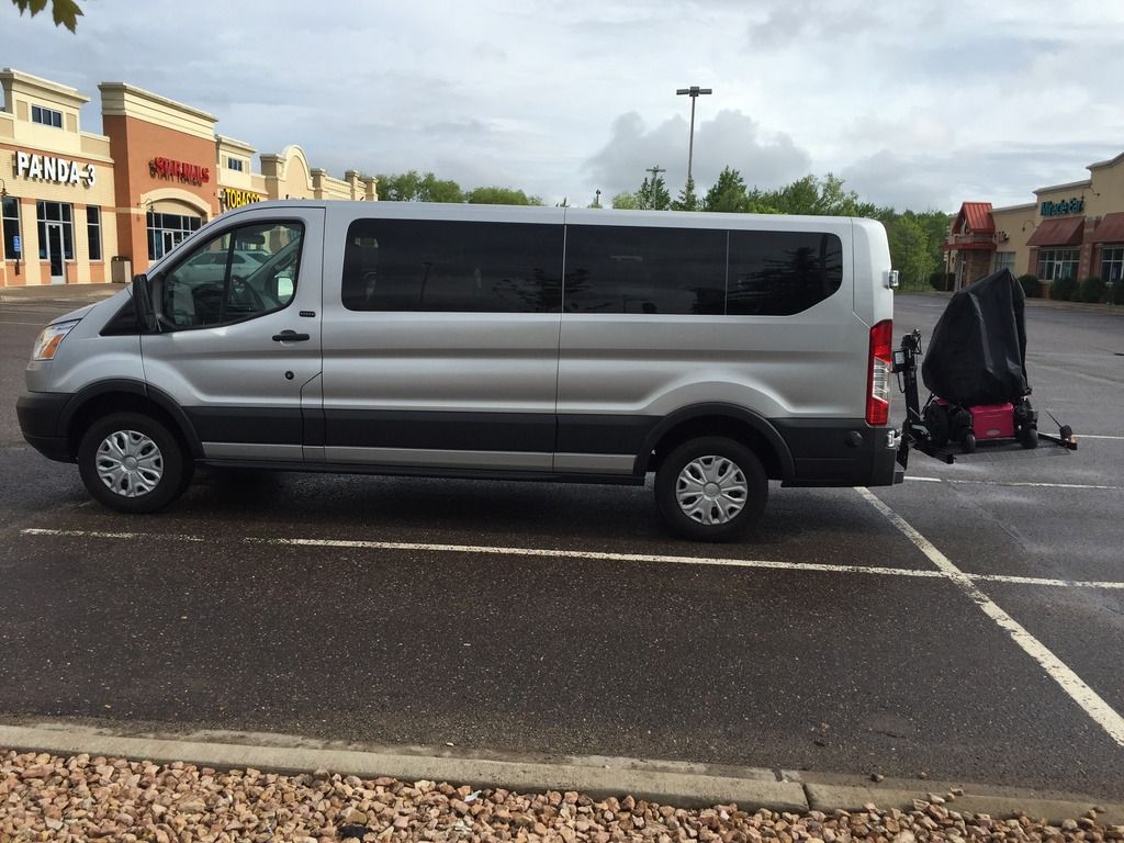

I have the same hitch on mine and really like it. For the last couple months it's carried my daughter's power wheelchair on a hitch-mounted lift. In all, 480 lbs on the hitch, and no signs of any issues. Good choice!
Nice wheelchair lift. Our daughter uses a motorized wheelchair occasionally when her muscular dystrophy gets the better of her. I went with the Harbor Freight cargo carrier that I have to drive the wheelchair up and onto. If we have to use the chair more often, I'm definitely getting a lift like yours.
Thanks! I thought about something like that, but I needed it to be able to function on the hitch of my F150, which has an 18" hitch height. The chair is 338 lbs, which is more than I thought my wife could get up the ramp with that steep of an angle. It does well on grades, but that would be too much for it.
My health insurance paid for the lift, but they're kind of pricey. I think they paid around $4,100 for it installed. It's a Bruno ASL-250.
Sorry to hear about your daughter, ours has spina bifida.

The Curt Class 4 hitch is where it's at. Beefier than the stock ford hitch and more bolts with more surface clamping area to the chassis than any other aftermarket hitch. If I ended up with a van with the ford hitch, I'd replace it.

Just finished installing mine this evening. Definitely a quality piece of kit. I dunno about that time estimate though. 15 minutes for a pro and 30 minutes for a DIYer? I spent about two hours, most of it trying to fish the bolts through the rear frame. Ha. Had to buy a specialty 9/16" drill bit too, but it also looks like a quality piece of kit, so I can't complain. Just glad to have it done.

Yup, fishing those bolts was definitely the hardest part for me. Don't remember how I finally got them in, but the design of that rail sure made things difficult.

For posterity, and the benefit of anyone else doing this install, I'll describe how I fished the bolts closest to the rear of the vehicle, as those were the hardest and the instructions didn't help much:
I inserted the bolts and rectangular "washer" from the end closest to the rear of the vehicle. There is a hole at the top of the frame tubing. I fished the line through the exit hole, then brought the rectangular washer and bolt in.
At this point, the first thing I tried was to insert the bolt into the washer and just tug it toward the exit hole with the line, but that ends up binding the rectangular washer against the slanted piece of metal in there (see the diagram in the instructions).
Instead, I turned the rectangular washer on it's side and inserted the bolt. Again, this is all with both the bolt and rectangular washer inside the frame tubing already. I have very small hands. I can't imagine someone with large fingers doing this.
It's counter intuitive, and I can't quite visualize how it helped, but for some reason having the rectangular washer on it's side with the bolt inserted allowed me to tug the line and get the bolt to come through the exit hole without the rectangular washer binding on anything.
Hope that saves someone an hour. It was very frustrating.
There may be a better way to do it. This is just how I ended up getting it done. Good luck!
