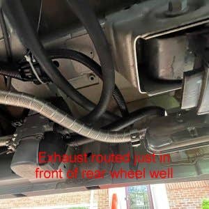

I'm looking to copy the locations that both of you used for the furnace and glycol hose routing.
  1. furnace bracket - I'm thinking about using Send Cut Send to fabricate a bracket to interface between the Espar bracket and the van metal. Do either of you have additional photos of your interface bracket? I assume that you used rivet nuts in the van metal to attach the bracket to the van, but how did you attach the Espar bracket to the interface bracket without interference of fasteners?
  2. glycol hose routing - The hose routing that you used through the floor of the wall cavities is ingenious. On the interior of the van, it looks like there is plenty of room for a drill and a hole saw. Underneath the van, however, I'm struggling to see how you managed to drill holes there. The forward mount for the leaf spring seems to interfere with any chance of accessing that location with a hole saw on a drill. How did you manage to drill both of those holes? What size hole did you drill? Did you align the internal and external holes vertically with each other (i.e. vertical hole in wall cavity is directly above the horizontal hole under the van)?

We have the extended length T-350 and mounted the furnace behind the rear wheel and then routed the glycol lines through an opening near the rear bumper that has a rectangular rubber plug from the factory so that we didn't have to drill any holes. It makes the glycol loop a little longer but that has not caused any issues with heat loss.
I looked at that location but initially ruled it out because I was worried about the furnace getting blasted by road salt and sand during the winter. Also, it seems to be a bit more exposed to rock strikes because the underbody is not as deep behind the wheel as it is in front of the wheel. Have you had any issues with this? Would you care to share some photos? Thanks!!!
