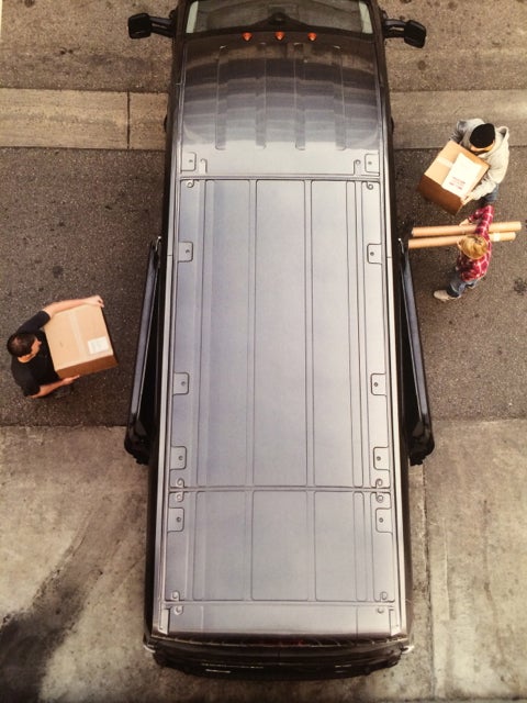

PS -- Here is a photo of one Transit roof's flat mounting points:
http://www.fordtransitusaforum.com/attachment.php?attachmentid=1857&d=1408896813
I think this is an extended length van BTW. My short low roof Wagon has a total of six flats.
