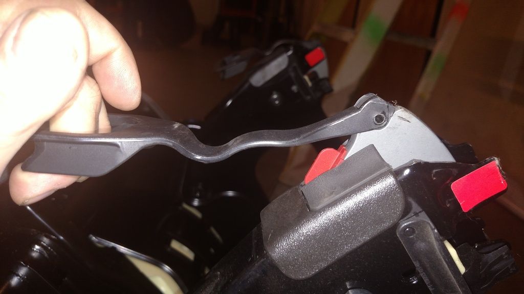

584 Posts
The seats are easy to remove. The only caveat to that is that Ford only provides the handles for one set of seats. But if you contact your friendly Ford dealer, I'm sure that they could order a second set of handles for you. They are a five minute installation. It's just a loop that goes down and is attached to the release lever by a roll pin.
Here is a picture:
