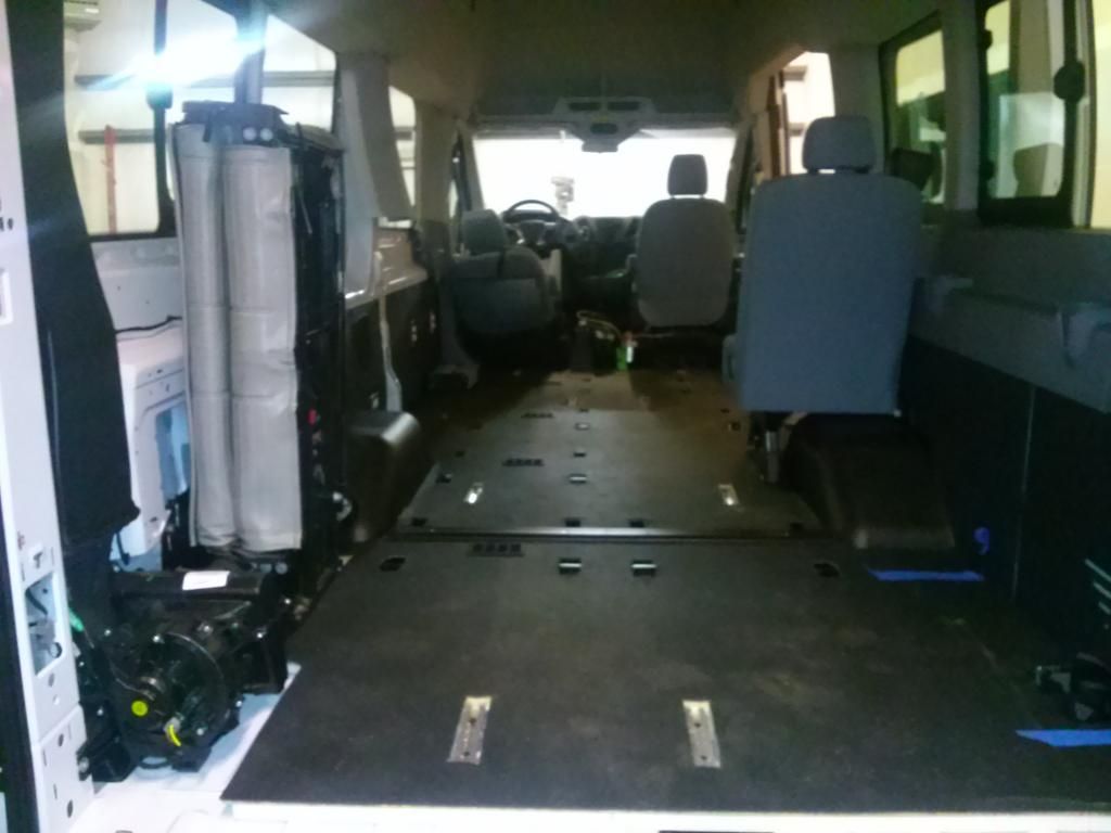

The story is that the transportation company that I work for bought a bus line and they had already ordered this 2015 15 passenger wagon. LWB EL HR DRW. This is part of a contract so we have some requirements. It has to be wheel chair accessible, it has to have Wifi and it has to have 110 volts available to most of the seats.
I do work for an electrician so he came over and traded repairs for installing the outlets and the wiring. He left a plug to plug into the inverter so I just need to put the inverter in, get it wired in and plug it in. There is a post on the rear, outboard side of the drivers seat base that is fused to 60 amps so I will pull power from there. There is also a plug under the seat base that has a grounding signal for engine run. This will ground a relay so the inverter will only be on when the engine is running.
The wifi, I may power from this same plug since it has a key-on power signal. I am imagining I could run the wire behind the panel next to the drivers seat, then up to the over head compartment.
We bought a ramp and I will build a rack that will bridge over the rear mounted jack up to the left wheel well and the ramp will be strapped to that. Under the rack will be storage for tire chains and other supplies. Then it needs tie-downs for the wheelchairs. That is my next biggest headache. So far I have missed the right placement of two out of two holes in the flooring. The second one, I hit the heating duct. I will be taking measurements so that, hopefully others can learn from my mistakes.

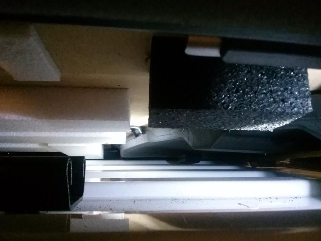

Here is a picture of the front end of the heater ducts.
It comes off of the underseat housing and splits off with a small section coming almost straight back and the main section turning in this curve then going back. I'll post some measurements later.

Last night I realized the dimples in the flooring are where the spot welds are and they do a good job of defining where the frame and supports are underneath.
Now if I didn't have 13,000 other things to do, I could focus on this thing and get it on the road.

I still have to tighten all of the bolts, but I have all of the major stuff in. I still have to build a rack on the left wall to hold the wheelchair ramp, but right now, I want to get everything else bolted in and get the seats in so that if it needs to roll, it can.
I did find the part number for the connector to give me my engine running ground signal and the plug is there, I just have to bring the wire out. I don't have the cover for the inverter built yet. The sheet metal shop I use is backed up so I will have to wait to put the inverter in and wire in that signal wire and main leads, but it's not a big deal right now.

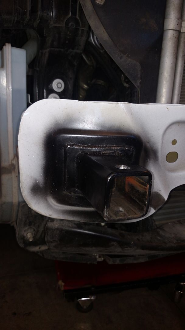

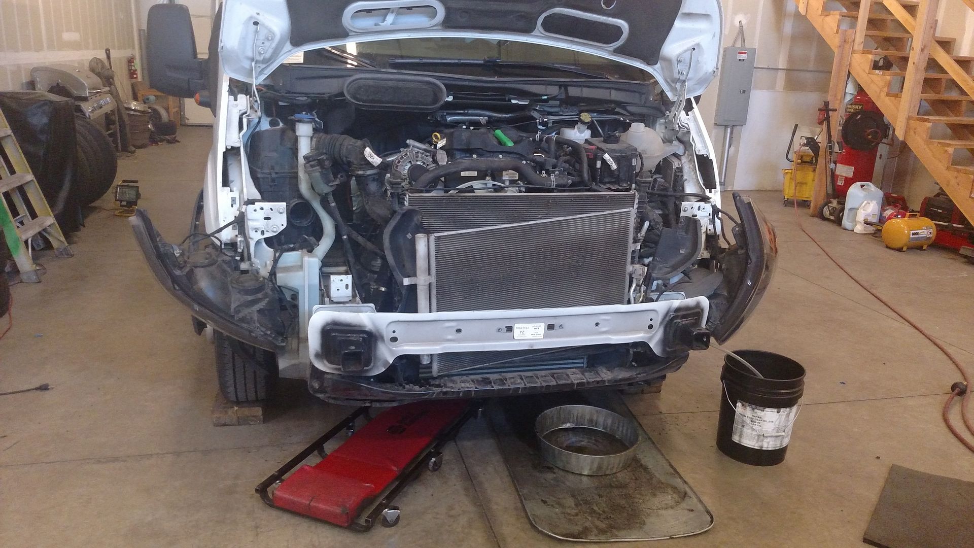

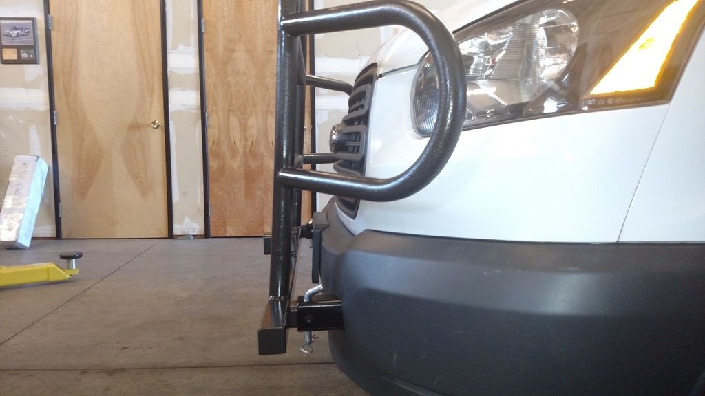

We had our deer guard installed this week and incorporated a receiver for a bike rack.
I have the rack turned around so it's not poking out front in the way. It's certainly more difficult to access the dipstick for short people, but for normal people, it's OK. Certainly not ideal, but the other option is major repiars and down time when they hit a deer. The route this van takes is a major deer thoroughfare, so the deer guard is needed.
We had the base guard from our old van and a local fabricator built the brackets and swept back the headlight guards. He welded the mounts to the front of the crash bar rather than removing it, so everything structurally is still intact. It's not really easy removing the assembly, but I shouldn't need to very often. Unlike on our 6.0L.
Looks great, do you know its weight? Also curious if you ever weigh the Wagon full of passengers, especially the front end weight with the new guard.

The tubes coming out of the bumper cover are welded to the front crash bumper. I was going over this in my head and the only thing that I could come up with is he would need to have a crash bumper to weld on the tubes. Then what would he do? A core charge where you send him your crash bar.
I wish I had taken a picture with the bumper cover off.
