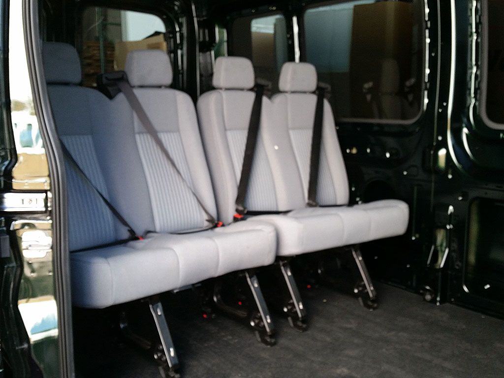

Well I just completed an order for some new 2015 Transit seats off eBay.
This seller had 3 person and split 4 person seats that matched our upholstery.
The shipping ended up more than I had hoped for (~$700, ouch) but it netted out cheaper than going with the individual jump seats I'd found (~$250/seat, w/o tax and shipping). We regularly freight ship at our biz and I checked with shipping person and it was pretty much inline with what he thought it would be for the distance.
I will think about the mounting once they are here. They did include the OEM mounting brackets.
My plan is to mount the 3 person in the 1st row and the 4 person in the 2nd row with an option to move the right side 2 person split behind the 2nd row 2 person on the left if I want to load something longer or possibly a motorcycle. I will have to see how the dimensions work out.

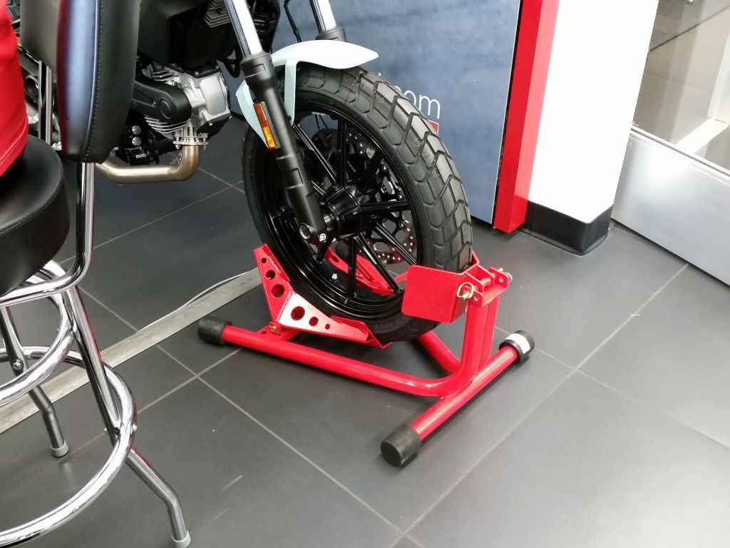

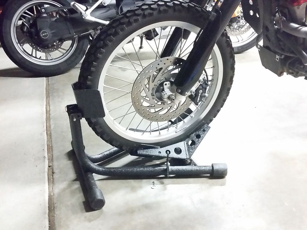

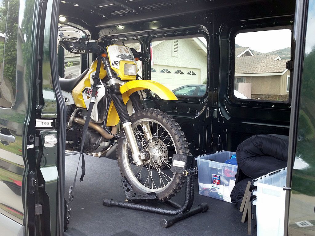

I received the Baxley sport chock yesterday.
I tried it with 17, 19, and 21 inch front wheels. It works great with 17 & 19 and "ok" with 21.
I looked at it and realized with some judicial grinding on the front stop mounting brackets you can flip the front stop over to move it up, then use the rear holes, and then it works much better for the 21" wheels. Why Baxley doesn't reprofile the stop mounts and make use of this is beyond me, it seems natural.
This is how it looks "stock" in the low position.

I got a chance to try loading one of my bikes in the van this weekend. I was really impressed with how secure it was using the wheel chock and only 2 tiedowns. If it were a heavier bike I'd be using 4, but it was ROCK solid with this setup.
Now, to find that set of arched folding aluminum ramps.....

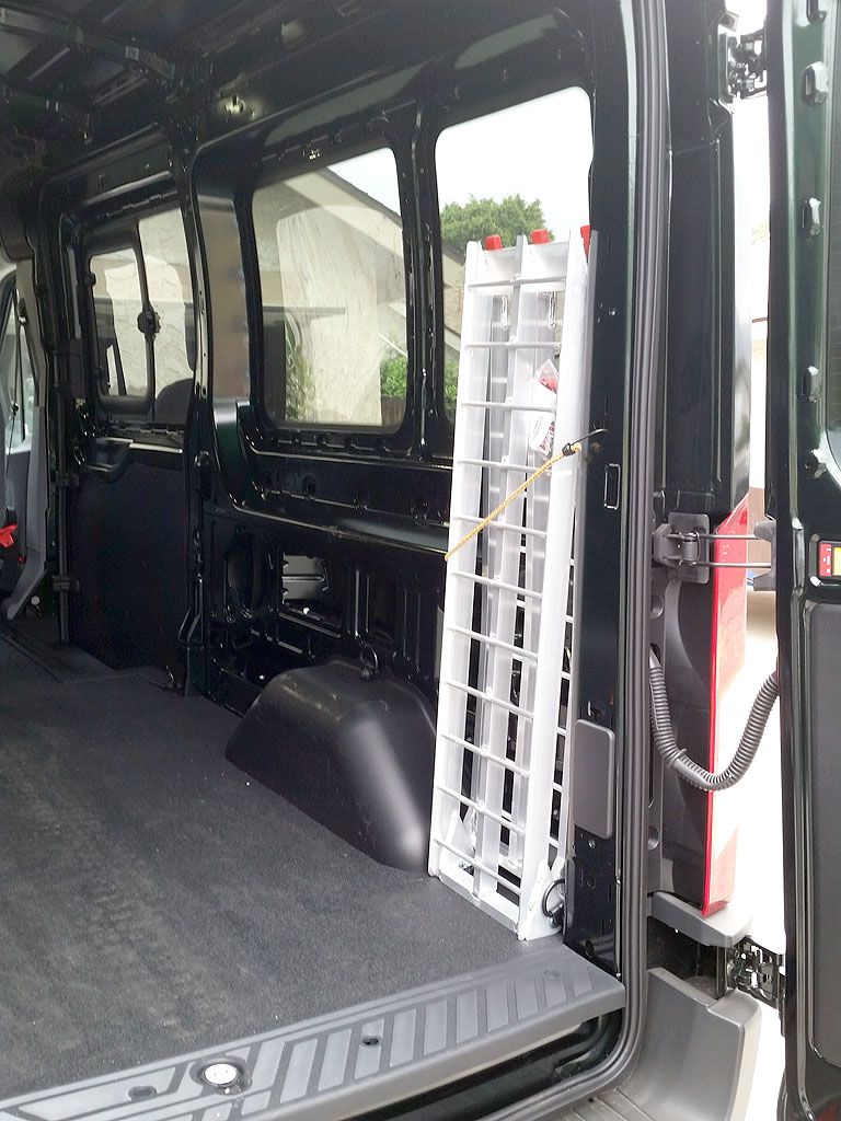

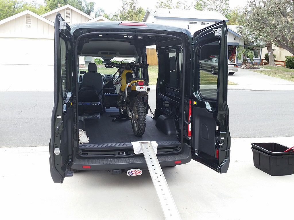

I pulled the trigger on a set of these arched aluminum loading ramps and got to try them out with my heavier Adventure bike yesterday.
They are rated at 1,500 lbs for the pair though it seems like more than I'd probably be comfortable with. They are a tad flexy when you stand on them but they handled my 600+ lbs ADV bike pretty well as the load is spread out over two wheels.
The flip side of them being slightly flexy is they are pretty light and easy to handle. They will store nicely strapped vertically to the wall behind each wheel well.

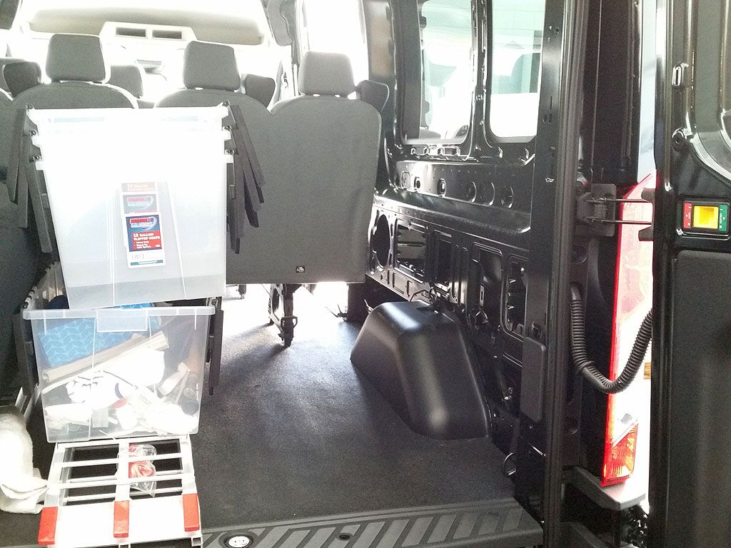

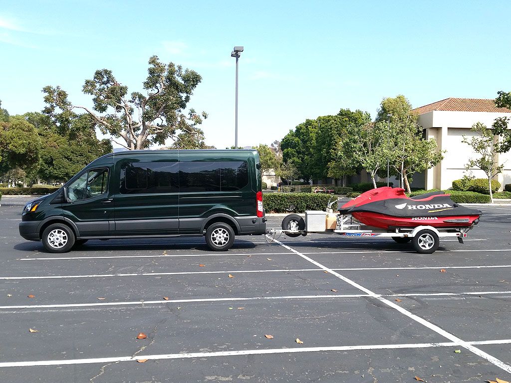

I did my first test tow today. It went pretty good overall. The only thing that didn't work out so well was I found I have no power to my trailer connector, either one the flat four or the round 7 pin. I don't know why but it's going back to the dealer to let them figure it out.

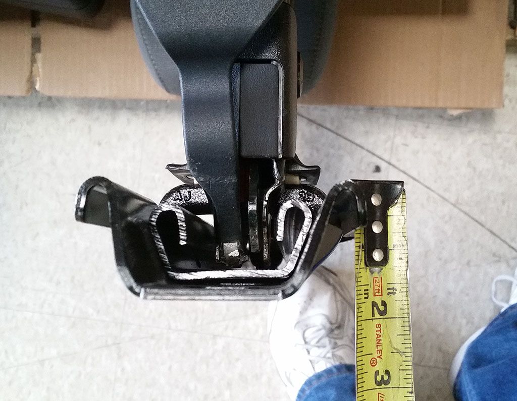

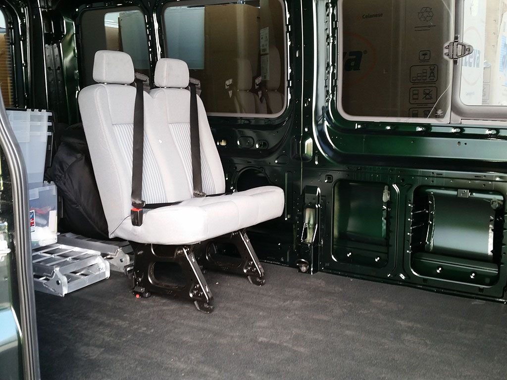

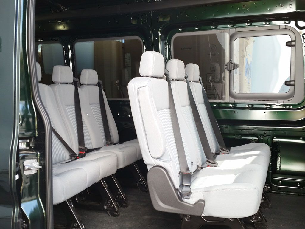

My seats arrived today. So I had to do a test fit to see how things might look.
Now I gotta get busy with the tape measure and figuring out my final mounting scheme. I have all the OEM brackets and might make use of those in some manner.

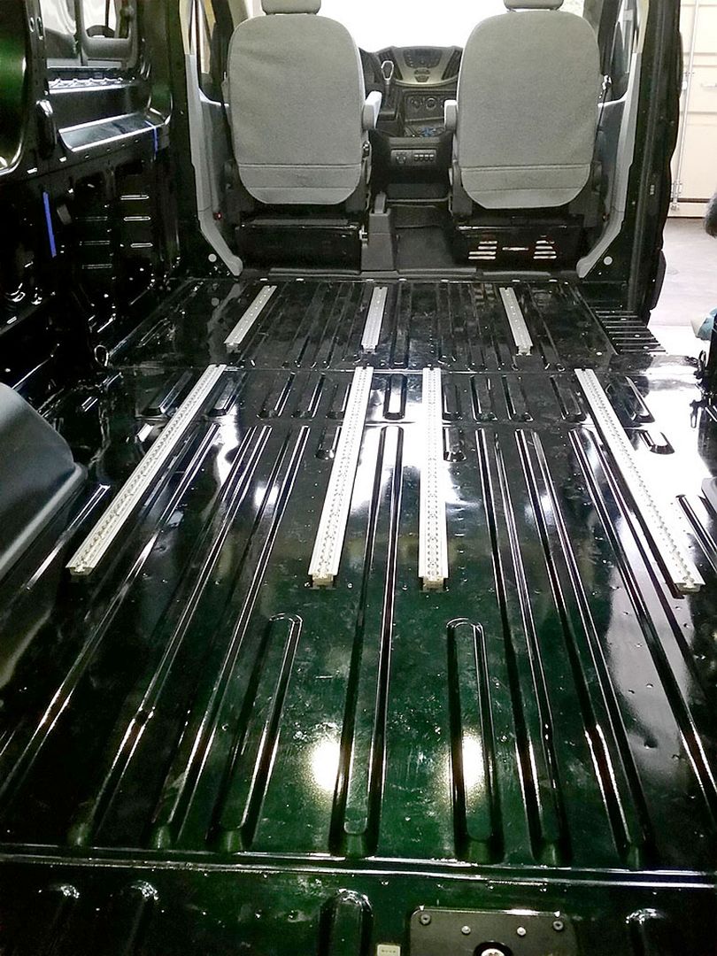

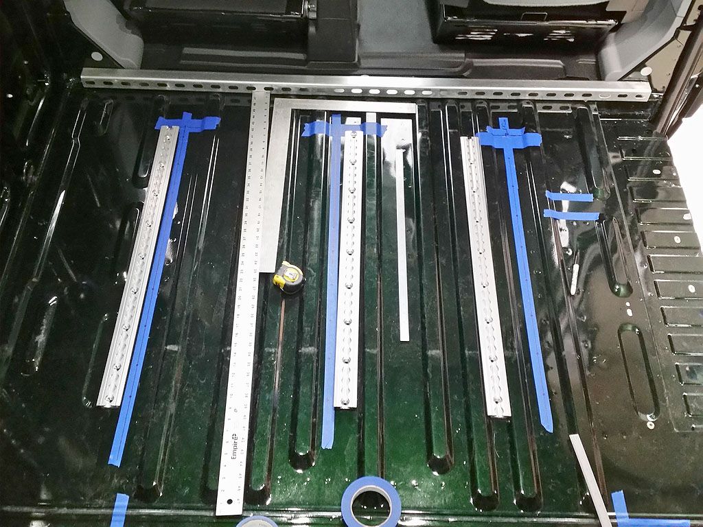

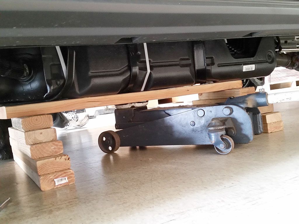

So.... I finally got the L-track in the floor and the seats installed, major project, about 4 solid days of work with 2 people.
The most time consuming part of it was the layout and figuring where we could drill or not.

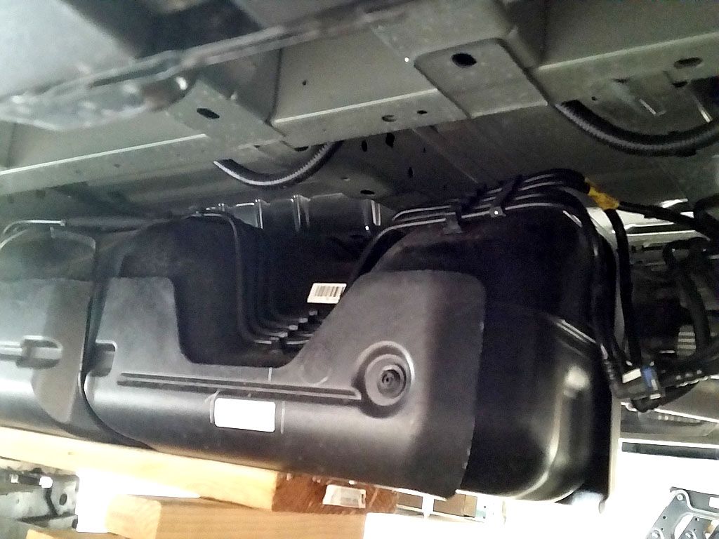

We lowered the fuel tank which was quite easy and did not require any disconnects. 6 bolts, 3 each side for the support straps and it's down.

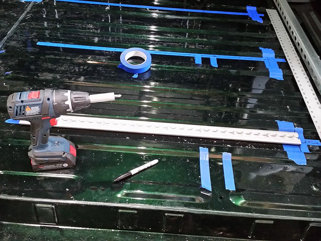

We then started the layout being as precise as possible
And drilling begun. I machined a drill stop to prevent going any further than necessary.
Here's some of the L-track laid down.

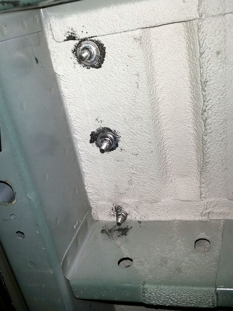

A view from the bottom. I put silicone on the holes to help seal them up and hopefully prevent rust on the edges.

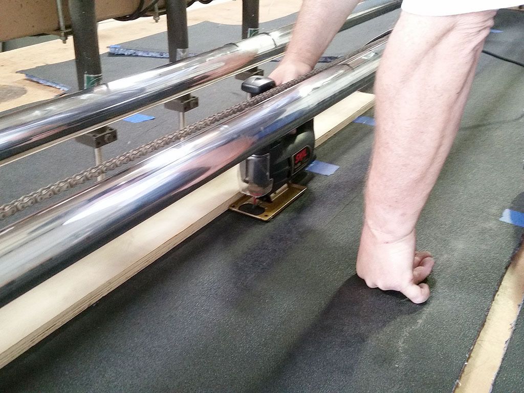

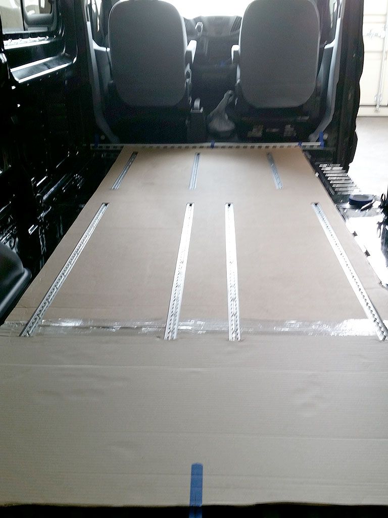

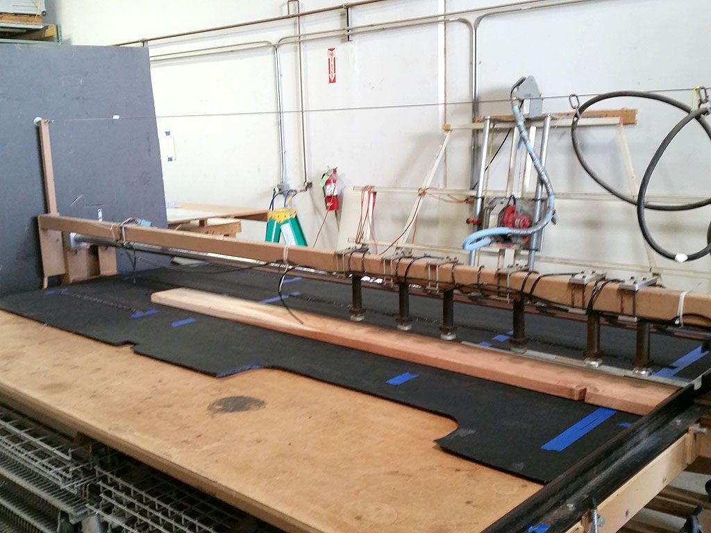

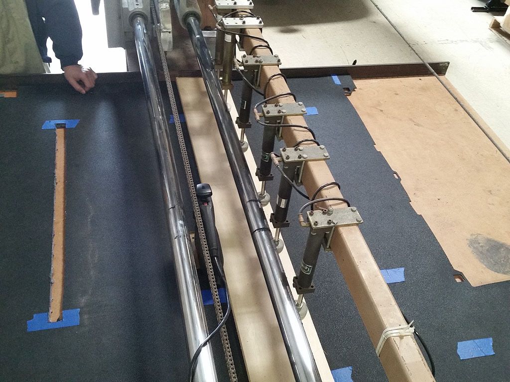

After all the track was down we made a huge template from cardboard so I could figure out the openings to cut in the floor mat.
I was fortunate to have a large beam saw table to work on that was ideal for clamping the fence and provided blade clearance for the hand jig saw.
This is how the openings worked with the L-track

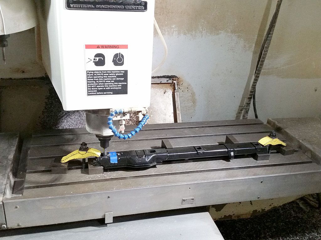

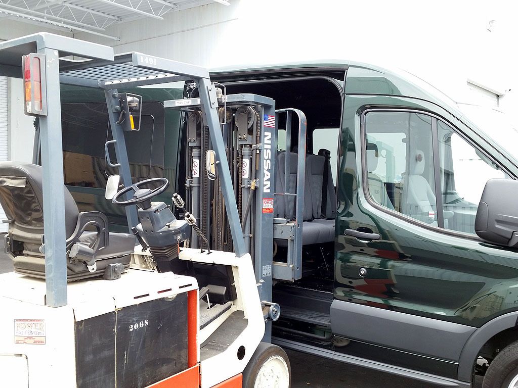

I had to modify a couple bolt openings in the OEM seat brackets to line up with the 1" pitch of the L-track.

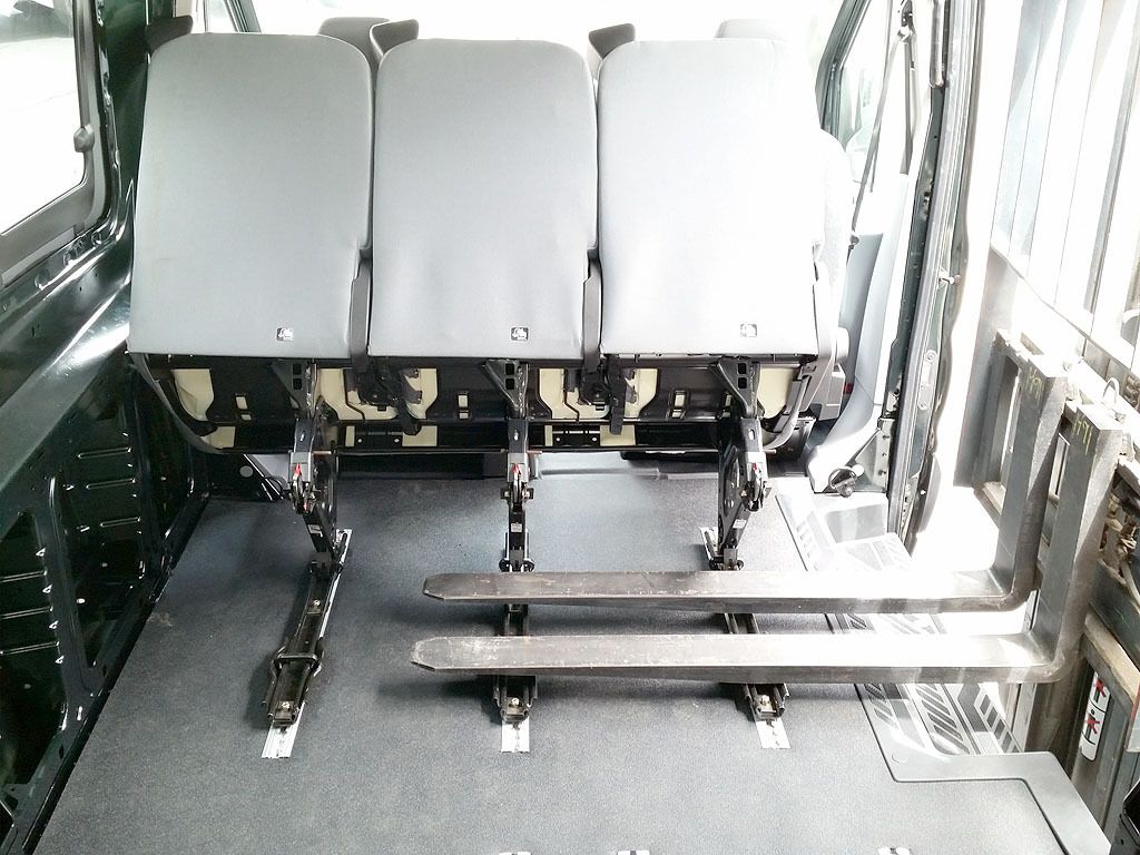

After getting the brackets all bolted to the track it was time to install the seats. Fortunately I had just the right tool for those heavy seats, LOL.
A view from the side door with them installed.
And from the rear.
