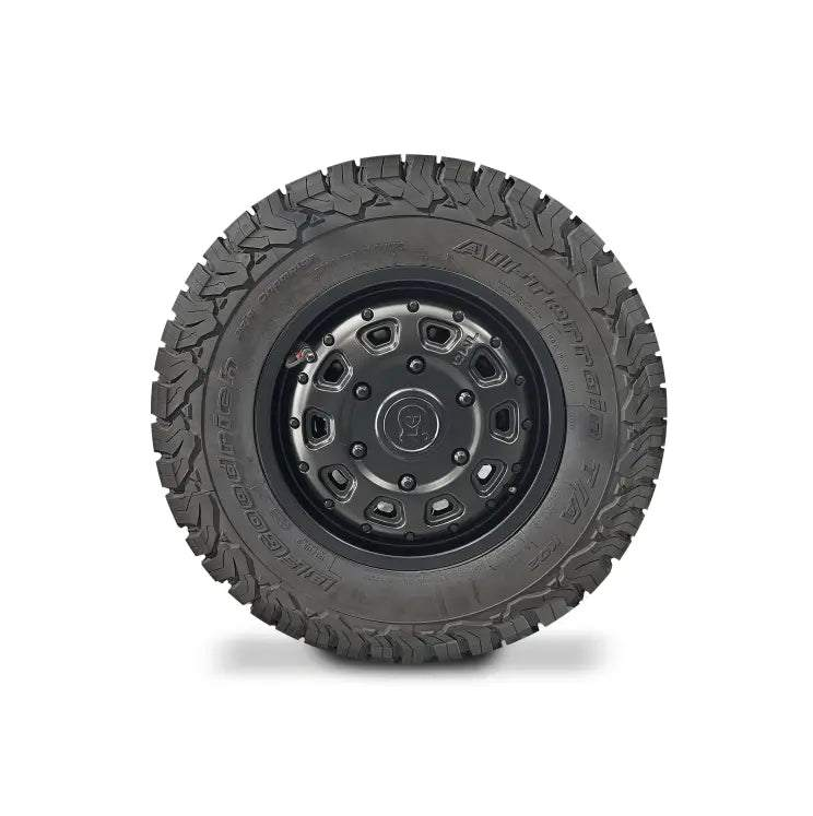

The overwhelming factor for me was looks. Another factor that would've affected my decision was how they help in low tire pressure situations. If you find yourself in situations where you air down your tires, two features of some aftermarket wheels are worth considering.
"Bead retention ridges" can help keep the tire on the wheel in challenging off road situations while aired down.
"Duel valve stems" can make airing down and back up much quicker.
Those features are talked about here;
I almost brought the Owl Vans Talon wheels, which have both of these features. However I ended up finding a steal of a deal on OEM alloys.
