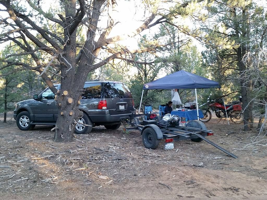

Here's my current setup, sleeping in the SUV. Biggest problem, it's either you or your gear in the truck, but not both at the same time.
