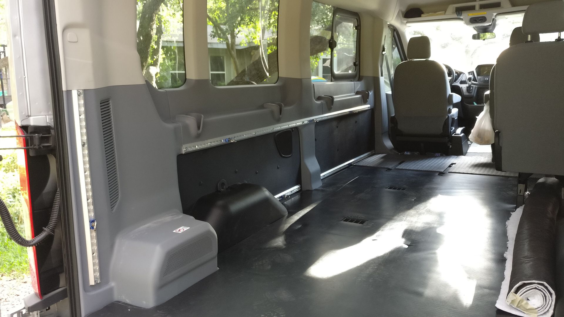

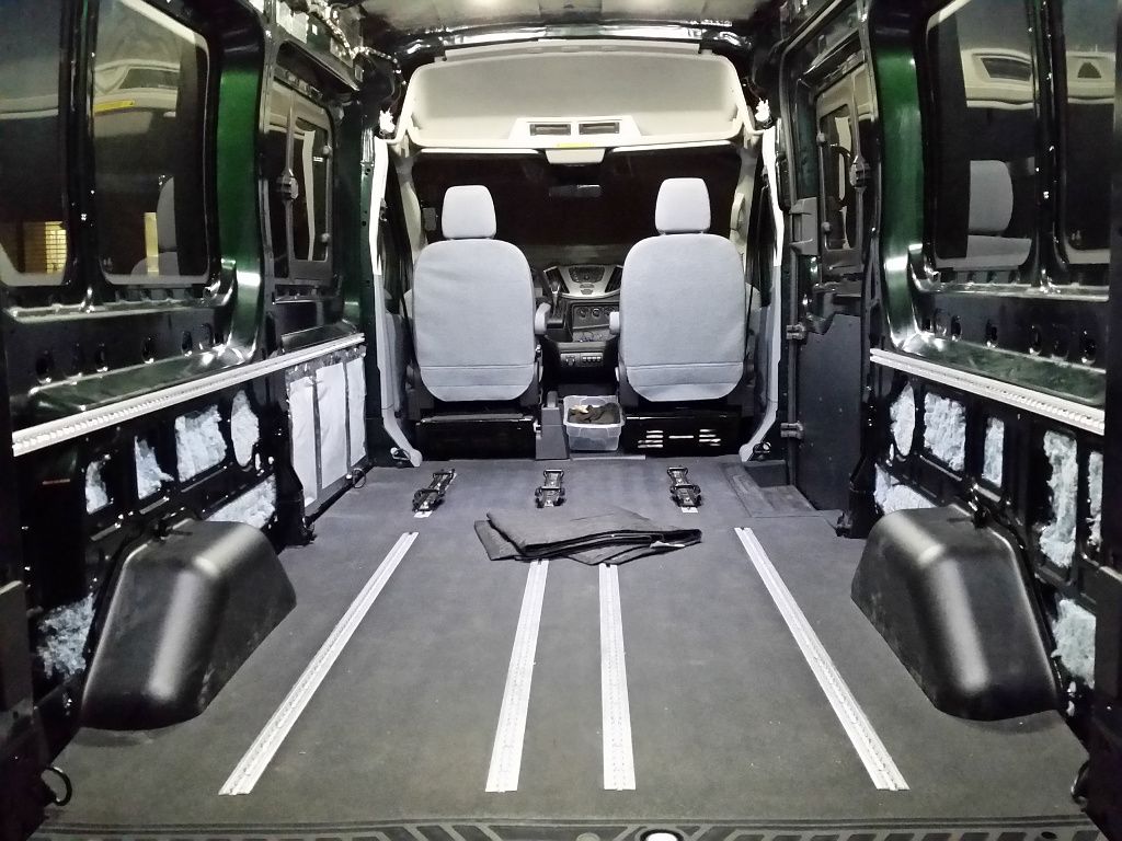

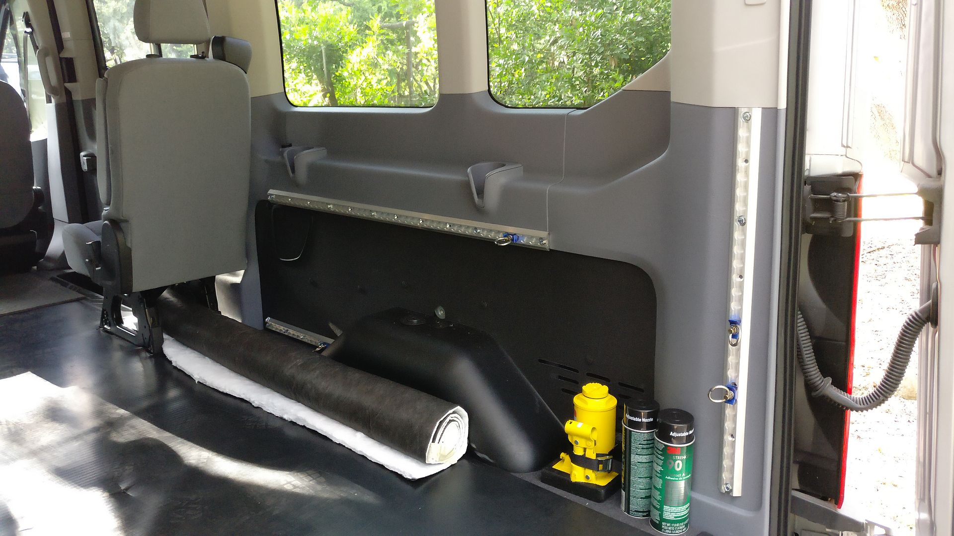

Got L-Track installed today. Very happy to finally have tie down points. I would have preferred to have the bolts flush but I can change them out myself. Took Auto Xtra 6 hours to install the insulation that I got from Hein and to put the L-Track up. I'm glad I did not attempt to do it myself if it took the professionals that long.
Next, I want to put 2 strips on the ceiling.

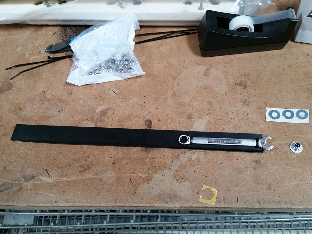

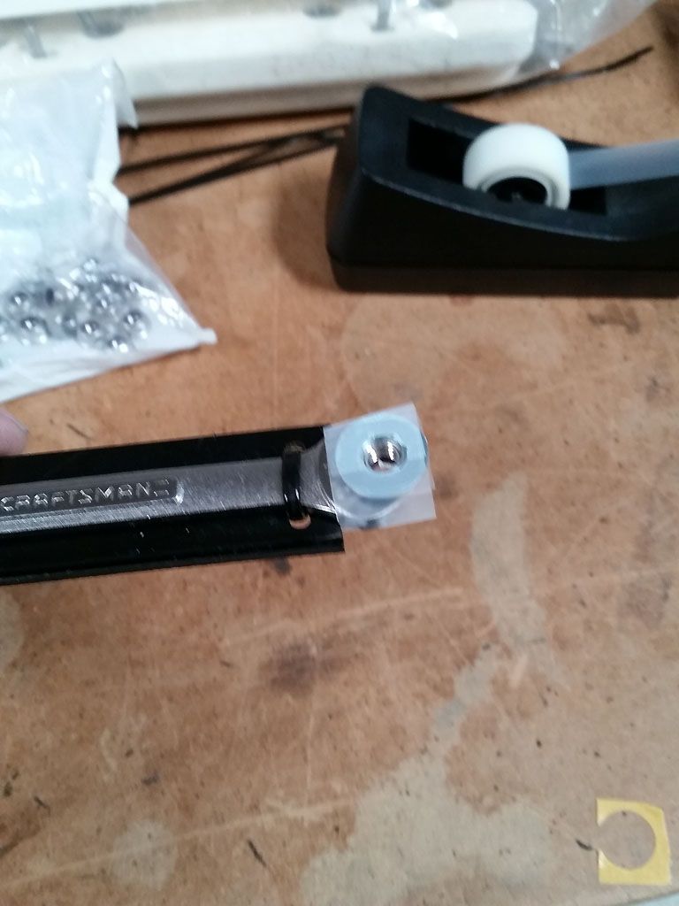

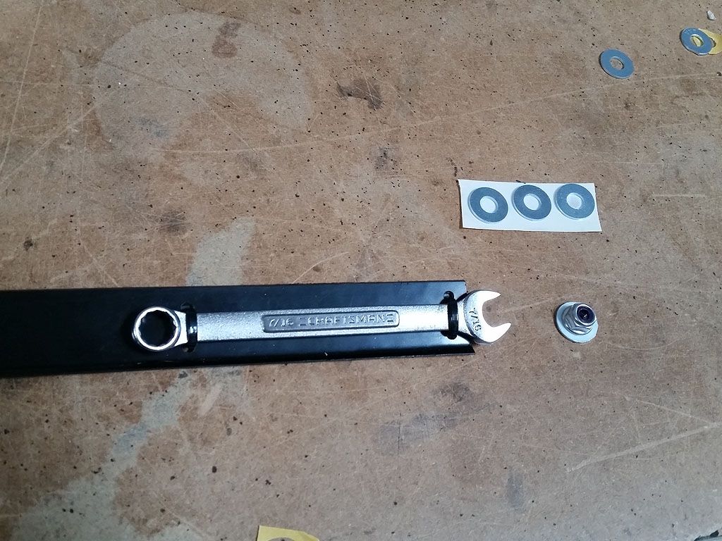

I used through bolt with nuts for all of my L-track, floor and walls. I used 1/4-20 SS flat head allen bolts with SS nylock nuts with SS washers. I was able to reach most of the holes in the walls pretty well but for a few I had to get real clever and made a flexible wrench extension to reach up into some areas.
Here's a few photos of the wrench extension I made. The black section is a piece of 1/8" thick ABS plastic sheet I cut and drilled. I zip tied the wrench to the plastic. I used double sided tape to hold the washer to the flange nut and then scotch tape to hold the nut/washer assembly to the open end of the wrench. When I was done tightening I pulled down hard and the scotch tape would break free allowing me to remove the wrench.
If there are areas you want to mount L-track where it's just not feasible to reach behind I'd use rivnuts in the sheet metal then attach to that. There are a few areas I just didn't drill for bolts as it was impractical but for both the floor and walls there's only a few places with no bolts.
