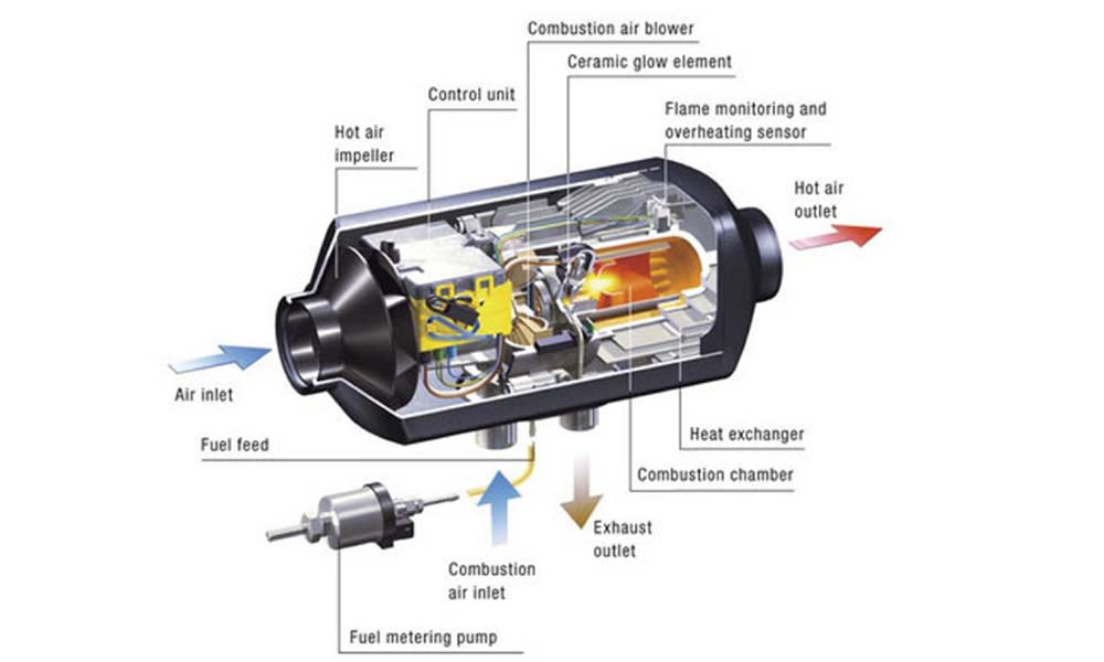

No, seriously... there are no injectors. Or a carburetor. Or valves. Or much else. I'm not sure how best to describe how simple they are. I'd say they're closer to a jet-engine... but that doesn't sound simple (even though it is). The diagrams barely help because it sure SEEMS like there's something more going on.
There's a, "glow plug," which is commonly found in a diesel engine (with no, "spark plugs," there, either). Basically, once the combustion starts working it keeps going so long as there's fuel delivered. I think the, "combustion air blower," is the internal air-mover that keeps the combustion air moving through the chamber (more similar to a jet engine in that way - once it ignites it keeps burning so long as there's air-flow and fuel available). But this is just my understanding... there's an Aussie guy on YouTube who has a series of videos where he goes through every aspect of these things.

The fuel metering is done by the controller and the pump. The "pump" is sometimes called a metering device or something like that; it never delivers a steady stream of fuel - just little "bubbles" of fuel, basically. The, "tick-tick," noise people hear is the fuel pump metering the fuel.
All the coking that tends to occur with these things is typically solved by running them leaner. That's also the issue with altitude: they need to be leaned out at higher elevation or they will coke-out if they run at all. The newer controllers use altitude to lean the fuel supply.
FWIW, this metering thing is also why they end up with issues when using a varied-size pickup (factory aux line): it's not developing a head of fuel the way that a legit pump would do. The water pumps we use in our sinks, for example, just push a steady pressure / head of water then they're "metered" by the faucet. This setup is more like the faucet is always fully opened and the pump turns off and on constantly to regulate the total flow of water.
The design was first built (and patented, if I understood that Mick guy) over 100 years ago. It's a simple device.

Wouldn't there be some kind of nozzle or atomizer for the fuel at the combustion chamber? I get that the pump cycling meters the fuel, but surely it doesn't just drip out into the combustion airflow?
The pump in a parking heater is called a dosing pump. It delivers drops of fuel to the combustion chamber. You can hear the solenoid in the pump click as it pumps drops of fuel through the fuel line.
If I understand the diagram - can't recall anything from when we rebuilt a friend's unit - there's a fan of some sort internal? I'd guess that's as atomized as it gets?
I’d think if it just drips into the combustion chamber, you’d run the risk of air getting into the fuel line. Air, fuel, and flame in a tight space? Seems like a bad idea in this case. I still think there has to be a nozzle or some restrictor that keeps the pressure inside the fuel line higher than the pressure in the combustion chamber.
Gum up the WHAT? :LOL:
That looks more like a clothes drier than a Jet engine : D
