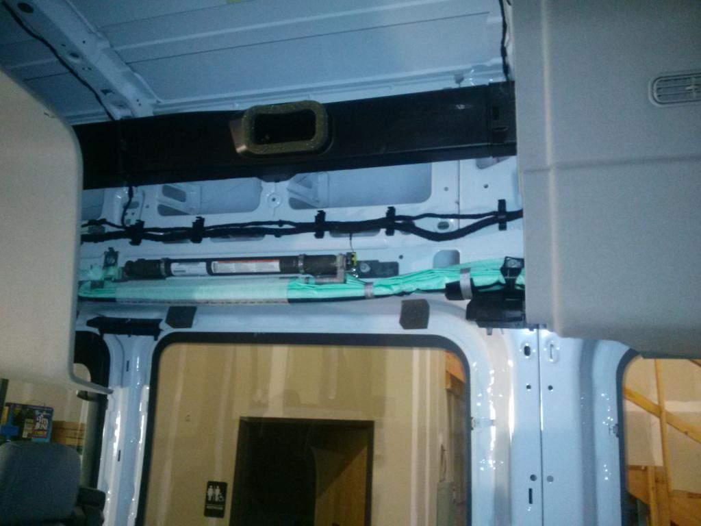

Good: full interior plastics, flooring, headliners, underfloor heating, rear AC, and full length airbags, and the seat rails provide additional mounting options for cabinetry.
Bad: the airbags prevent full overhead cabinetry, had to devise system to mount stuff from ceilings w/o screwing up the h/l.

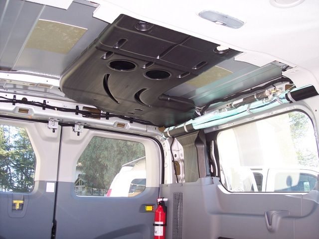

These are photos that I got off this site. I would love to give the owner credit but cannot find where I got them. I saved them for my own information because photos of wagons are hard to find on this site. Again, I apologize to the owner of the photos.
6
Reactions: 3

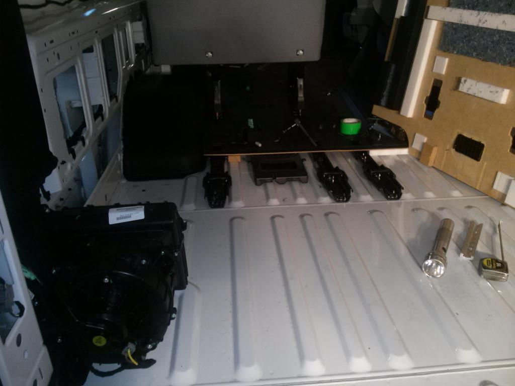

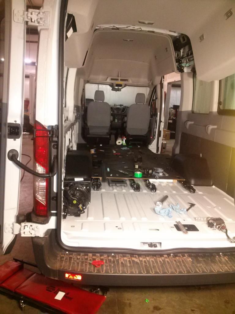

I am about 80% complete on my 2015 12 passenger. Removed seats-sold most of them. Removed curtain airbags-this is a real pain, do not recommend it. Removed floor and vent system for rear A/C unit. A/C unit remains. Installed Coleman roof a/c, Norcold 6.3cf Refer LP12v,120v,, Suburban H20 Htr,LP,120v,, 30x48 HomeDepot Shower w/sliding glass windows/combo Thetford Aqua Magic Toilet, RoofTop Carefree Electric Awning, 120v Microwave $99 sits on top of refrigerator, 20 gal horizontal propane(under), 30gal fresh water(inside), 30gal black water(inside), 30gal black water (inside), 6 gal black water (under). Level II Tank Monitor. Three Lead Acid Sealed AGM 200 Amp 12v batteries, 4000w Aims Inverter, 400 watt Renogy Solar-40amp Charger. Sterling12v B2B Battery charger. Fan-Tastic Vent. My bad for not posting pictures as I progress, but promise to do detailed pictures etc once finished. I would rather go to have my molars pulled than try to transfer pictures to this computer. Why am I standing upside down or sideways in my pictures? I will learn how to post pictures when I'm done. Started project mid-October 2015. Working at least 4 hours a day, 6 days a week, having too much fun. My first retirement project. Expect to finish by end of April..
