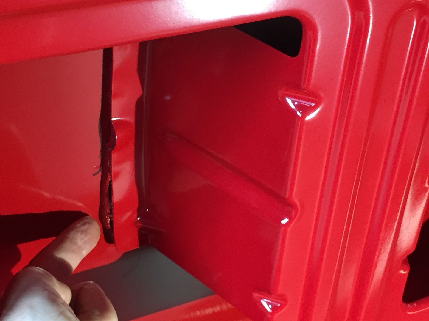

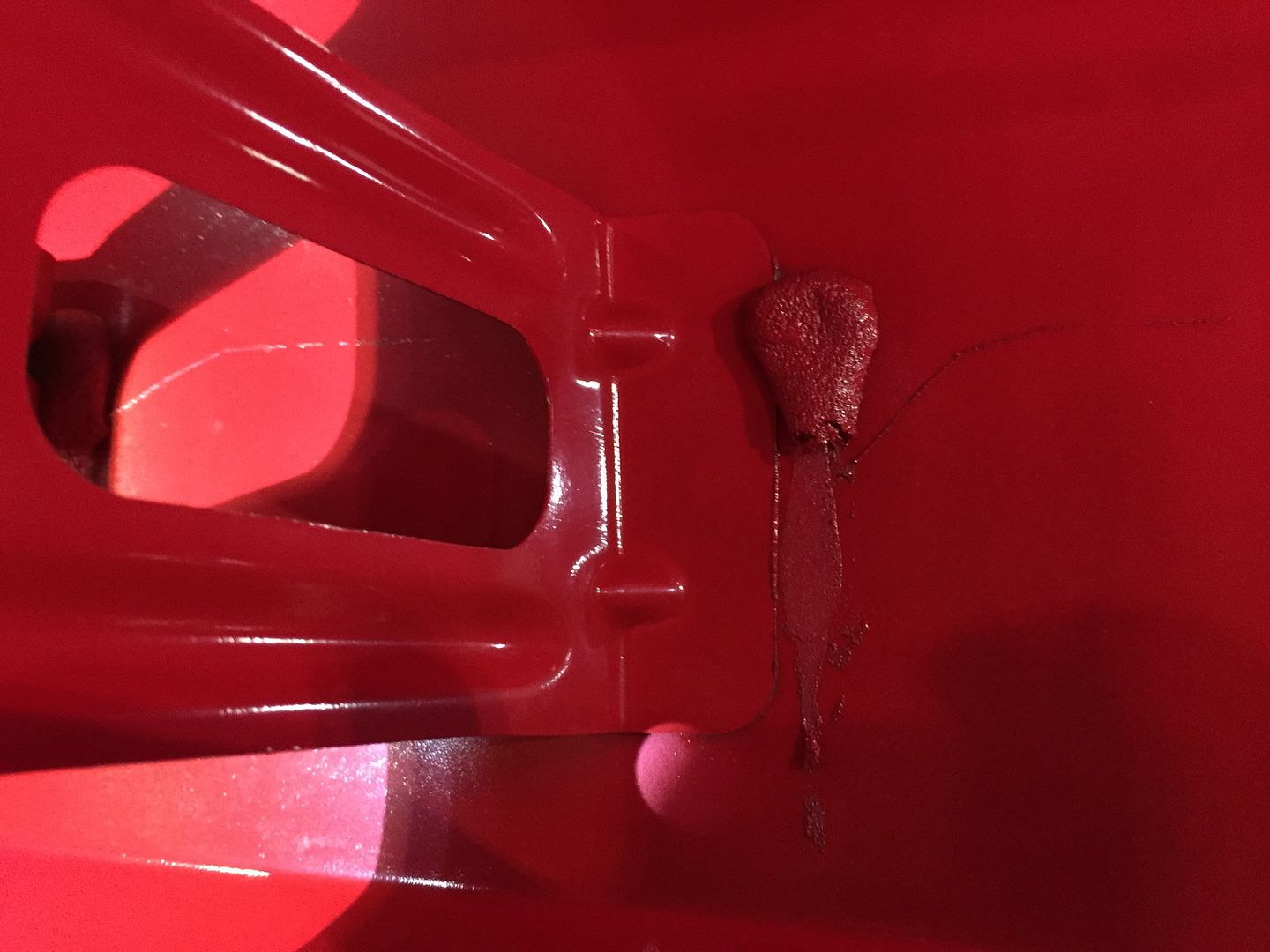

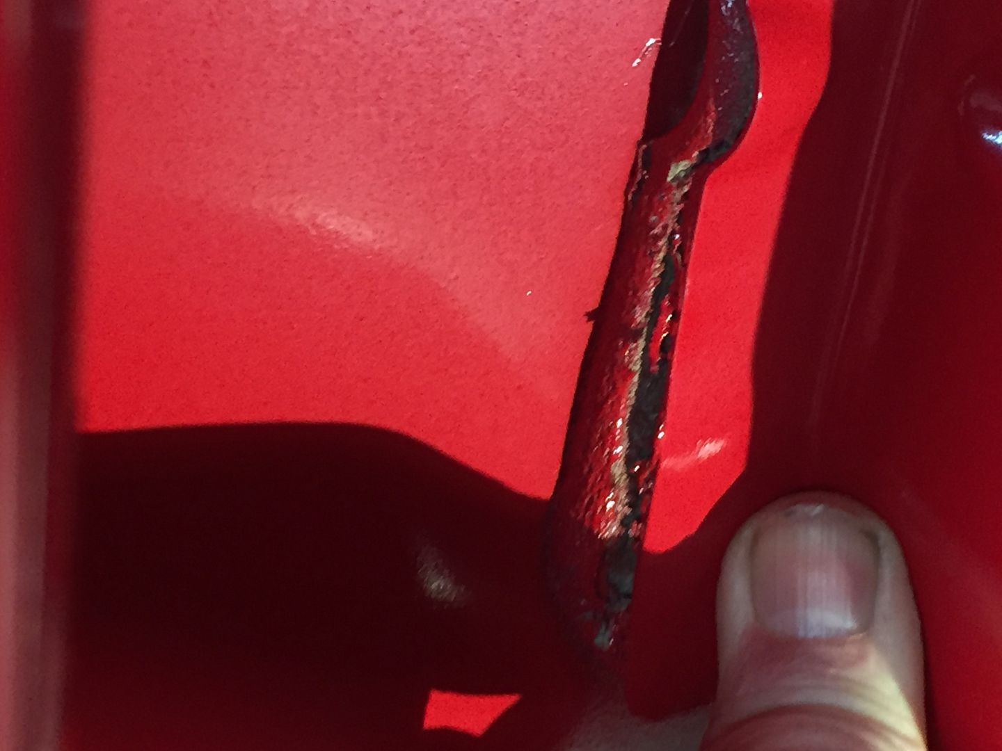

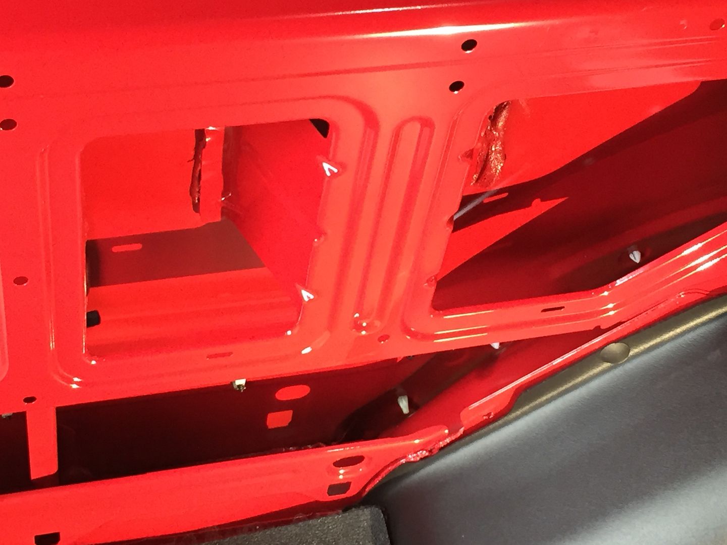

The joint between Interior wall bracing and Outer van skin
has a Sound Deadening Foam squirted in these joints -
This foam has basically ZERO strength --
I barely pulled on the interior steel wall bracing
and heard a Snap and bracing became Loose --
Looked on other side of van and this same
joint had Also Failed and I had not pulled on it yet-

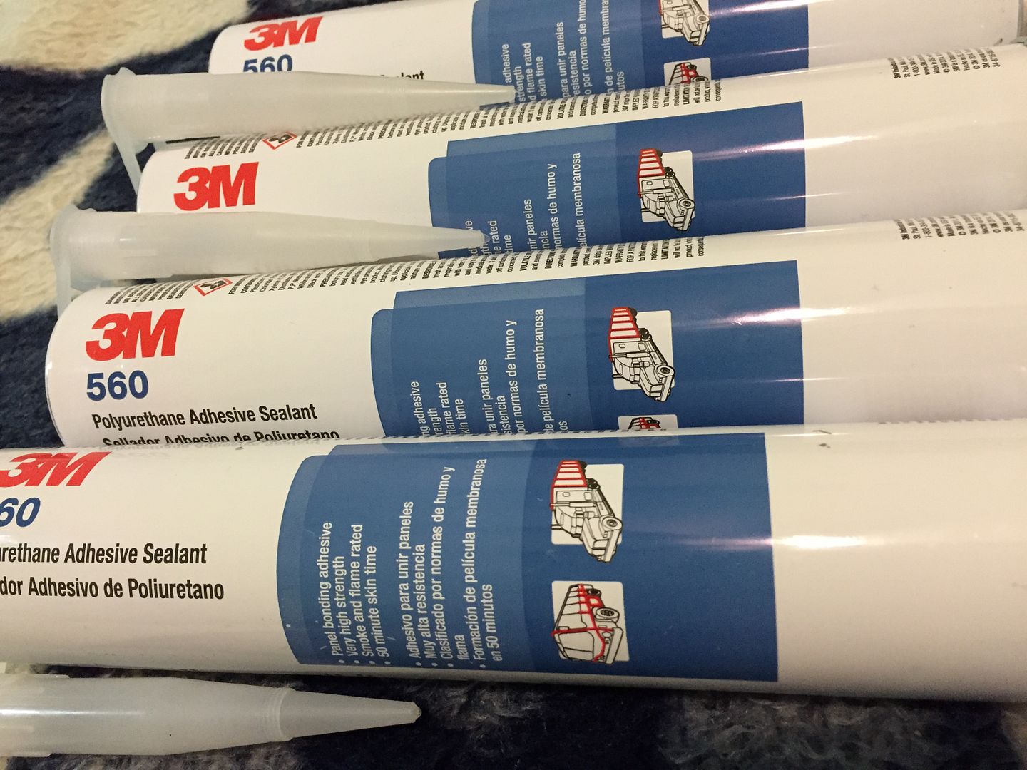

So went to Glue store and showed them what
the problem was and Jon said he had just what I need -

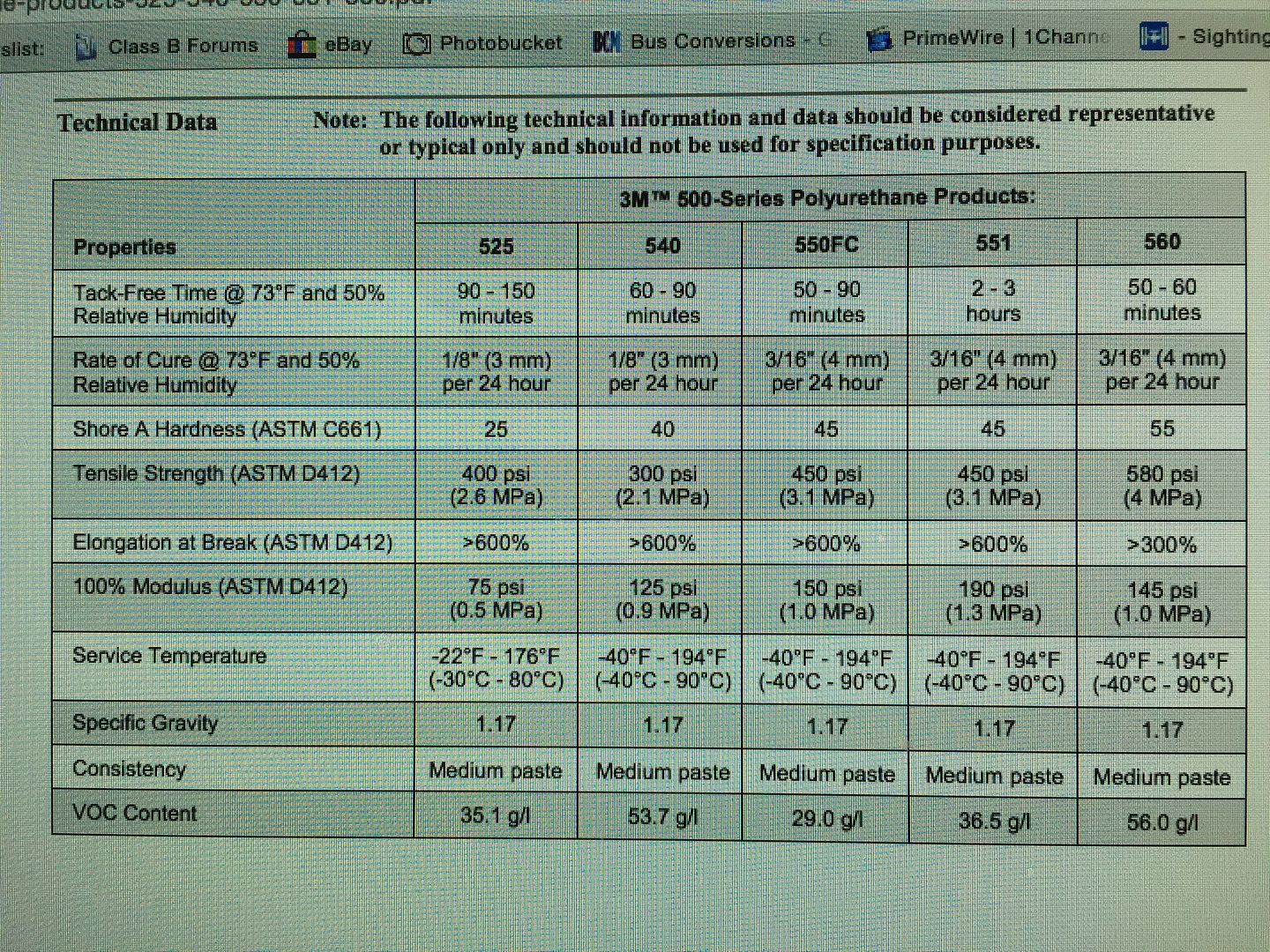

This 3M #560 - Polyurethane Adhesive/Sealant -
#560 is rated at 580 psi at failure -
Flexible -300% at failure
Operating temp -40 to 190F -
Has some sound deadening qualities -
$11 per tube --
So Im going to remove Most if not All of the
foam in the inner to outer skin joints and
put the #560 in its place --
The joint that failed is where the folding
bed bracket is going to be mounted -
Going to add further bracing in bed mount area-
but have not designed yet -

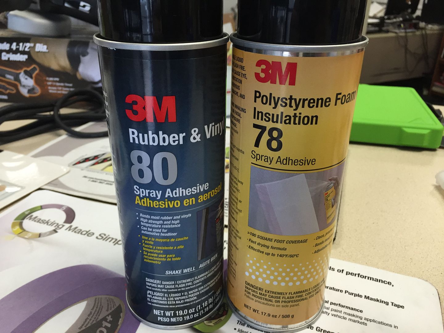

Also 3M makes spray adhesive to bond Foam
insulation to whatever #78 --
#80 May be for rubber type stuff - not sure-
further reading needed -
Joint failure area picts -
Look and see what shape yours is in ---><---
This roof brace is 95% missed -
$11 per tube --
