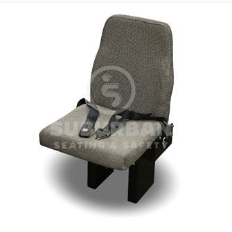

I'm thinking something like these jump seats that come with a seat belt for around $250 ea.

Keep in mind the OEM seats come with a lap and shoulder belt. They are completely attached to the seat, nothing goes to the body anywhere. I'm not sure on the 4 passenger seat since I don't have one.
