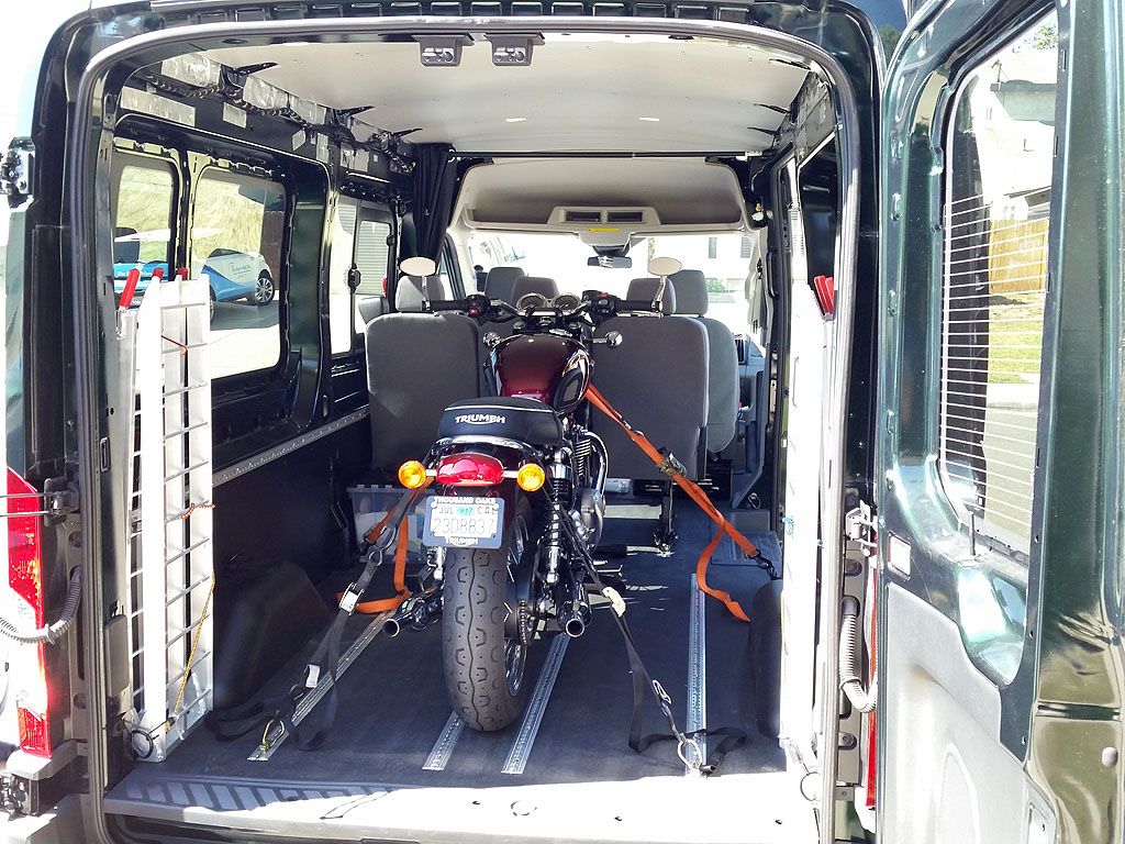

I used the L-track setup with the OEM brackets to mount seats in my Cargo van. I have the 3 person bench behind the drive/passenger seats plus a pair (L & R) of 2 person seats for the 2nd row.
Whether or not you will need to drop the fuel tank will depend on where you want to place the L-track. It's easy to drop the tank far enough without disconnecting the lines, that's what I did. 6 bolts on the 3 straps and it's loose.
Using the L-Track approach you can position the seats as needed facing forward or backwards, it's up to you. I am actually toying with the idea of mounting one of my 2 person seats backwards right behind the driver seat for camping purposes only. I need to play with it to see how it might work out.
I really like the 3 person bench and it stays in the van 95% of the time. I still have a full 8 ft of room behind it so I can load motorcycles etc. behind the seat.

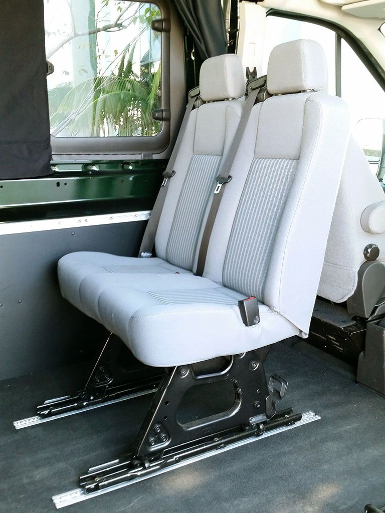

I found out today that my rear 2 passenger rear seat will fit in the left two seat brackets of the 3 person bench and allows for reversed fixing. This is the rear right side 2 passenger seat mounted reversed. I will use this setup when we are camping.
This same seat can be flipped back around forward facing without changing the seat brackets. For better space utilization though the rear left side 2 passenger would be better facing forward due to the offset.
